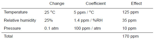

I ran across this in the past and again today (while looking for capacitance guard banding):
http://www.stools.com.cn/html/About.asp?ID=39
Love that URL! Shades of "Waiting For Guffman" ("stool capital of the world...").
At the end (7.2) they show the things that can change the dielectric constant of air:
Change in dielectric constant of air
This change can be enough to affect the accuracy of precision detectors, but it can be easily compensated by building a reference capacitor in air with materials similar to the sense capacitor’s and using a balanced bridge detector.
That solution doesn't seem to apply to Theremins very well with the expensive / large coils and such (unless incorporated into the fixed oscillator).
