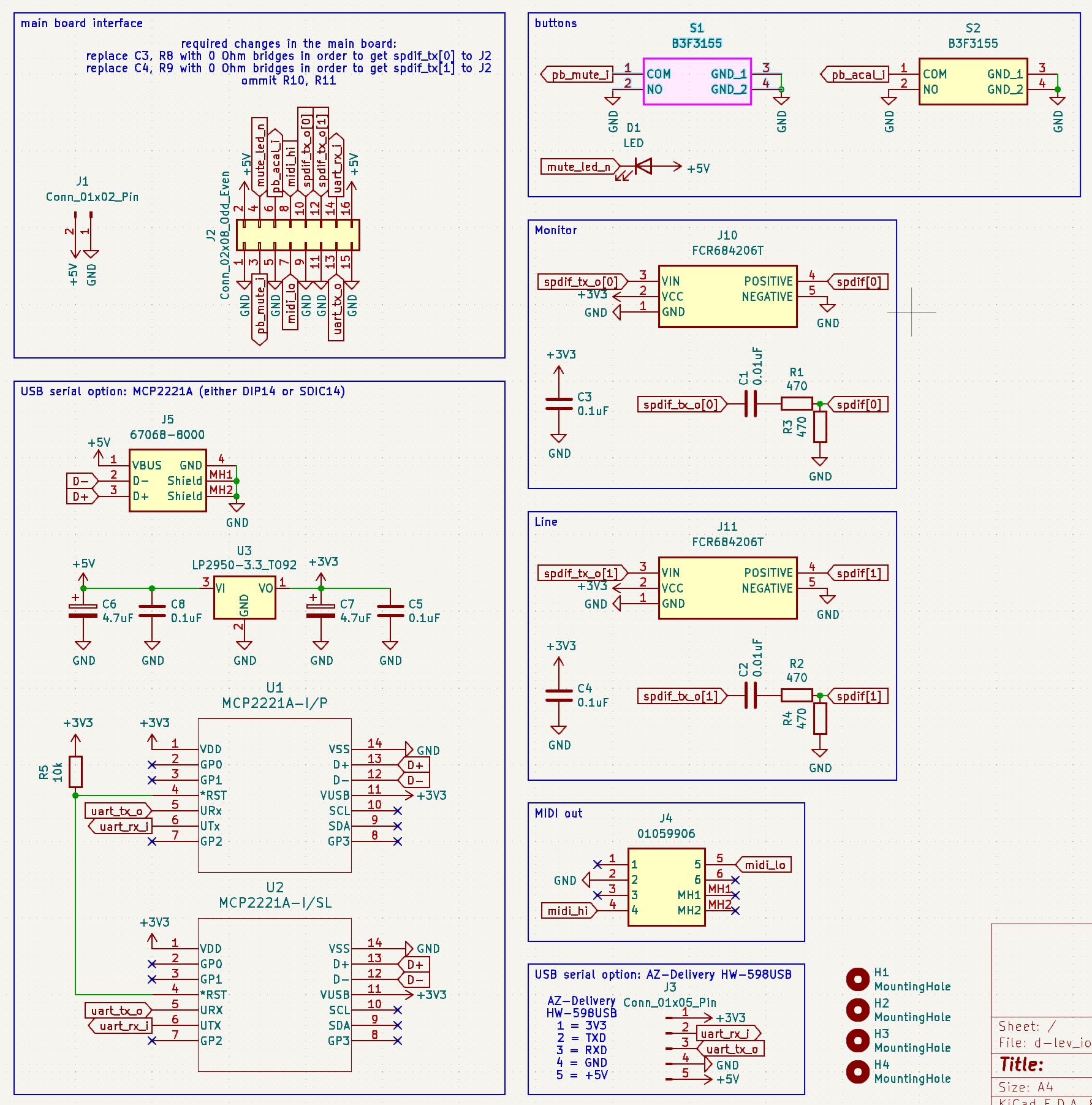

Finding the TOSLINK_TX part is difficoult.
post 1878: Buggins Q: "What parts are used in your design as optical (toslink) transmitter and receiver?"
post 1879: Dewster A: "https://www.goldmine-elec-products.com/prodinfo.asp?number=G16911B" with reference to Roger (pitts8rh) for the footprint.
This part is no longer available.
Just be the look of it, comparing with fotos of the main PCB, this ebay link may be it. These parts are obviously second choise with bent pins. Anyway I'd have bought them, but the parts will not be sent to Germany.
https://www.ebay.de/itm/111692790134?srsltid=AfmBOorU-U-4gMkfkj_Aws3tB-Ft9HFrAEjeiS5_0Bl4NWN_0WJSopwv

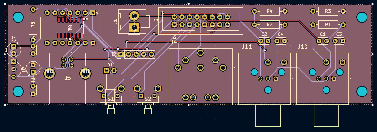

I may have to go for a different part Toslink transmitter and update the footprint.
As an alternative move the Toslink transmitter to the IO extension and connect it with a ribbon cable.
This could be the alternative: https://docs.rs-online.com/d4d9/A700000009791094.pdf
