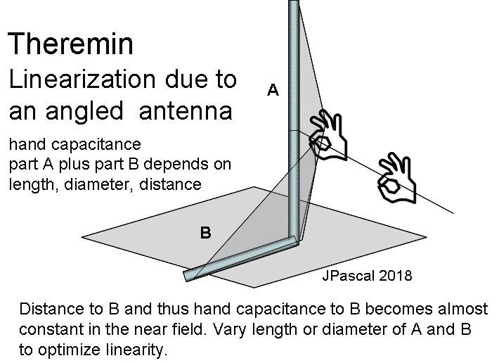

Also, like ILYA, I'm kind of curious as to the pitch field sensitivity and linearity of your designs. Are you using a series EQ coil? If not, I assume the sensitivity and linearity are pretty much fixed?
You should write a book, I for one would definitely buy it!
Maybe it's because of the angled pitch antenna.
http://www.thereminworld.com/files/photos/16058/angled_antenna_hand_capacit.jpg
