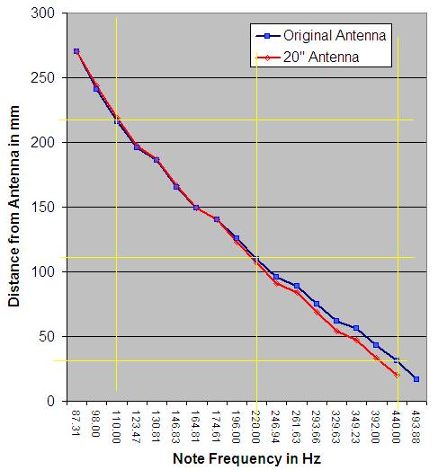

I plotted linearity curves for my Theremini using the original antenna and also for the larger $5 hollow chrome 20" antenna bought from my local hardware store.  The values used were from my earlier posted tests, when I moved my hand to change pitch near the base of both antennas.  Based on the results, I think I will use the 20" antenna from now on.  The linearity curves and a photo of my Theremini with the 20" chrome antenna installed are below.

Ironically, the default Excel graphing methods very often lead to misleading graphs when doing scientific or engineering work.
- I've found that I need to use "XY (scatter)" for the graph type.
- Either the frequency axis needs to be logarithmic, or I need to take the log base 2 of my frequency data. Humans experience frequency logarithmically, and log base 2 is neat because the integers correspond to octaves.  The Excel function is:
  =log(frequency in Hz, 2)

Interesting plots, Gary -
I have drawn verticals for each octave 'marker' (110,220,440) so it can be clearly seen that 2 octaves are spanned from about ~30mm to ~220mm.. This is in probably the most linear area of an uncorrected theremin response, so selecting this zone and placing your required not span here is wise!
IMO, this area should be quite playable - but one can see that even in this optimum zone, the higher frequency / nearer antenna (220-440 Hz) zone (horizontal lines showing vertical distances between octaves) is shorter than the lower frequency/further from antenna (110-220 Hz) zone.. This will expand out, and if you had set the theremini for a span of say 50-60cm in order to fit more octaves, the apparent acceptable linearity shown in your chart would disappear completely.
But for 2 octaves, ~200mm in the zone you have shown, should be perfectly playable.
The major problem, the reason why the theremini is difficult / impossible to play, is not primarily due to non-linearity..It is due to the 100ms latency! - As Keven Kissinger said, in terms of use as a theremin, this is a "show stopper".
And yes, it can be seen that the longer antenna is improving near-field linearity a bit.. Dropping the lower horizontal yellow line to track the red trace would reduce the difference in vertical length of the two octaves a bit.. But I am not sure that this tiny improvement is really worth the effort.. It may be if it does anything to compress the far-field (I have my doubts that it would) which is not shown in your plot.

Thanks Fred for the analysis of my data.  Yes the frequency data was from F2 to A4, just over two octaves.
Thanks Dewster for the Excel advice.  I redid the curves using the "XY (scatter)" for the graph type and formatted the frequency axis to be logarithmic as you recommended, and the result is below:Curves with Log Frequency & XY Scatter Type
