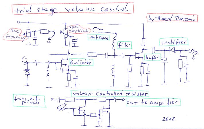

Here is the principle circuit, values will be added later. For the genuine narrow bandwidth high resonance level filter I have applied a patent.
http://www.thereminworld.com/files/photos/16058/theremin_volume_control_jp.jpg

This is really good stuff. I have not worked with them but I think those are NMOS fets? If the parts are readily available I would like to build your circuit and in the process make a PDF with your name on it so it will be etched into the board and others can enjoy your work.

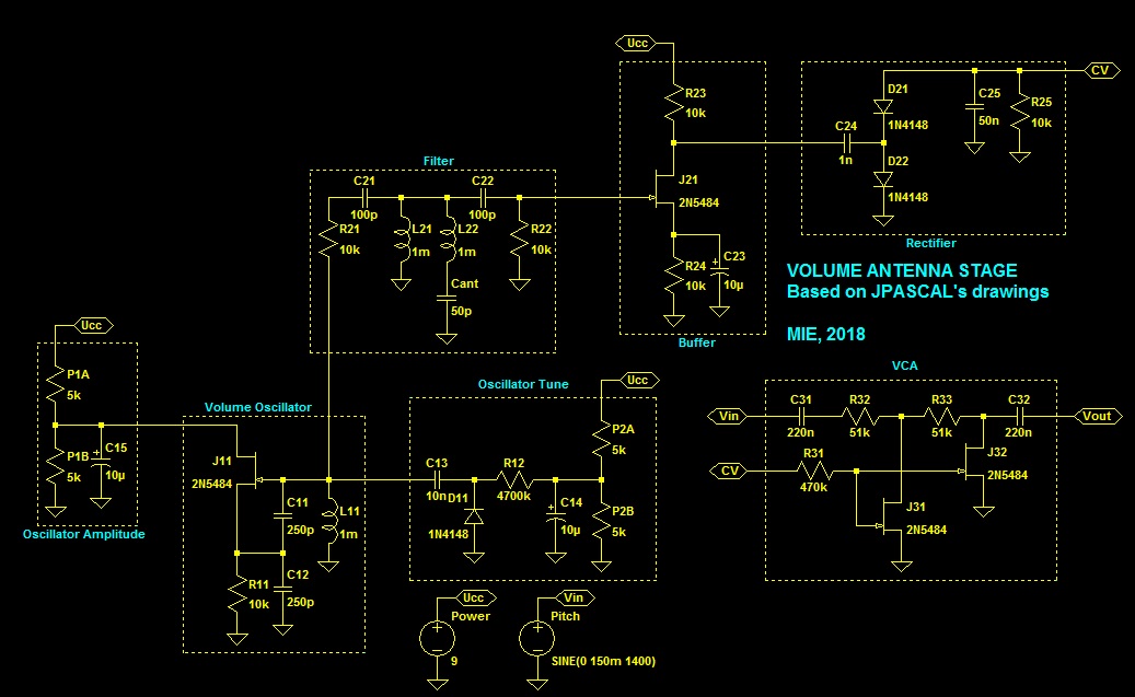

Hello, JPascal!
I tried to pick up the values of the elements on your circuit. Can you tell if something is wrong? Also, I had a number of questions:
1)L21 and L22 is one coil with a tap in the middle or two different coils?
2)Is it permissible to use 2N5484 and 1N4148 in this inclusion?
MIE
D11 is wrong, it must be varactor

Wow, MIE, you are hired! Answer comes soon. Can you post this as LT Spice file? Instead of the varactor diode a variable capacitor could be used.

Thank you. I have some questions:
First, has anything changed in the pitch scheme?
Secondly, what program did you use for spectral analysis?
Here is the LTSpice file:
http://www.mediafire.com/file/yc3kz1i7uo6j3xz/JFET%2528Volume_Stage%2529.asc/file
Posted: 11/16/2018 10:55:38 PM
JPascal
From: Berlin Germany
Joined: 4/27/2016
MIEcomes, Christopher,
now comes my drawings with the values. To the questions: Both coils in the antenna circuit are solid r.f. choke types. The self resonance doesnt play any role because oscillator is tuned at the serial resonance L1 + L2 with antenna capacitance. For spectral analysis of the a.f. signal I use program spectran. The sweep generator I used here with an oscilloscope is a radio service one  RPS 3301 Nordmende. Thank you for posting the Spice file, I will try to import it for testing. Transistors are jFETs, but this type is out of production. They have a 4..5 mA drain current at Vgate=0.
