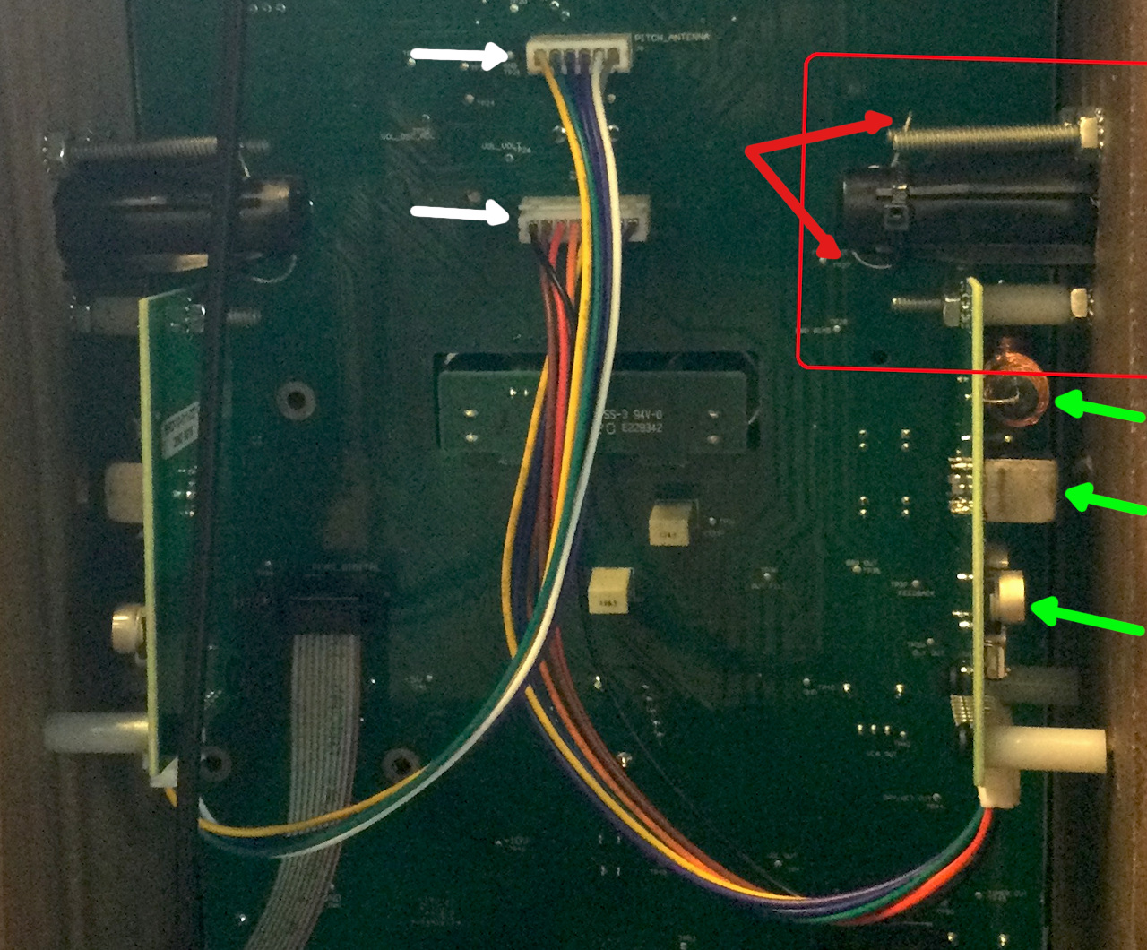

DiggyDog posted a Moog link to some pix regarding the Claravox volume issue (much thanks DiggyDog!):
I made a TW album with the two relevant pix:
http://www.thereminworld.com/album/claravox-pictures/17463
And I edited one to yak about it some:
The top white arrow is the connector for the pitch antenna board, below it is the volume antenna board connector. It's rather counterintuitive that the volume has more wires than the pitch (8 wires vs. 6)? The antenna boards look the same in terms of physical mounting, if so, one could presumably simply swap their locations to make a lefty unit?
The red arrows point to what I'm guessing is some sort of unused spring connector at the end of a plastic guide tube which has an unused solder lug at the top (you can see this better in the other picture). From the instructions, they apparently opted to use the lower screw and star washer to make this connection, instead of the spring connector. A better practice IMO would be to insulate the antennas from the wood, which they seem to have abandoned here.
The green arrows point to various components on the volume antenna board. At top is an RF choke, at middle an IF type adjustable can inductor with access through the brass eyelet - these are a strong indication that the oscillator is of the EQ type like on the Etherwave, which uses the series choke to help linearize the near field, and boost the antenna voltage swing. The bottom arrow points to what appears to be a trim potentiometer? If the boards are symmetric then there are two of them. Perhaps this is what needs to be trimmed at the factory / repair shop.
The bottom nylon spacer on the volume board looks like it has a gap between it and the cabinet wall. There are other IDC ribbon cables in there, so I wonder why they didn't use those to connect up the antenna boards, the inter wire capacitance would be better controlled. I also might try to keep those two cable assemblies physically apart from each other.
"To my eye this looks like a handwound coil. Am I very wrong?" - bendra
I'm pretty sure it's a commercial RF choke, like those in the EW. They're sorta scramble-wound, but there's a method to their madness.
