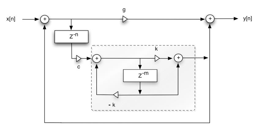

Implemented the filter from the paper I pointed to a couple of posts back, a comb with internal reverberator. It's quite interesting. Surprisingly, it can do OK human voices without any formant filtering whatsoever, and it can sort of add to the 6 format string patches (violin, etc.) to flesh out the upper end. And, being a delay / filter, it can do other fairly "wild" stuff one expects delays to do. I need to get the Q higher so that it can do bells better (decay is too short), and there is an issue now and then with high frequency ringing going on way too long, but it's fairly useful as-is:
The 'c' parameter is much like the Q control in a 2nd order filter. The 'k' parameter controls non-harmonic blend, and I find that I'm not using the 'g' path at all, which is straight through. As a formant filter it should be placed in parallel with the other formants, but as a delay effect it should be placed in series. You make either make 'c' signed or 'k' signed to get odd / even comb feedback.
