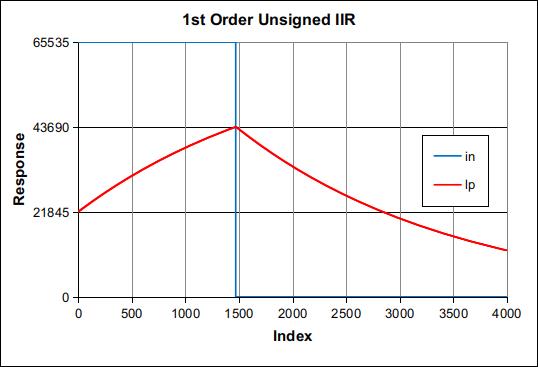

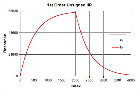

Full encoder pushbutton and GPIO debouncing is now implemented and running on the D-Lev.  Previously I wasn't debouncing the GPIO inputs at all, which is rather creepy considering one input is the external auto-calibrate for the axes.  The other is an external mute input, and I suppose if it flailed around a little it wouldn't be the end of the world (or your performance) but it's nice to have it fully conditioned as well.  The only encoder pushbutton in actual use is the one that performs the preset write, and I've seen it acting up at least once with what I presume was an ESD event in the room - the two step write process probably saved it from overwriting the current preset with whatever was dialed in, though what's generally dialed in is whatever voice is currently playing, so a wild write generally wouldn't change anything, but, you know, who wants wild writes happening?  The new debounce process here should improve the situation.
How do we debounce a bang-bang input, one that is either pulled high through a weak resistor, or pulled low via the very low impedance of the switch, and then double sampled to give a sharp digital threshold and eliminate internal metastability race conditions?  Previously I was depending on the only thing bringing the input low being the switch closure, and then continuously ORing the input for a while and then sampling & clearing, but that obviously isn't safe.  The right way is to stick a low pass filter with a time constant significantly longer than the bounce period on it, and then sample that at regular intervals.
You can use either a signed or unsigned first order filter, and I decided to go with unsigned because the input and threshold testing are simpler.  If the input is zero then we input a zero.  If the input is a 1 then we input a large positive value.  Then we do the filtering and examine the output to decide what to do from there.  The filter input values determine the filter output range, as the output range can't exceed the input under any circumstances.  I decided 16 bit accumulation in the filter was wide enough to accommodate a reasonable time constant of 2^-11, as the output maximum is then limited to 2^16 - 2^11, while the minimum goes all the way to zero.  Here is the filter with a somewhat shorter time constant, just to show you the response to the bang-bang input:
Above you can see it gives the characteristic RC charge and discharge curves.  The vertical axis here is 0, 1/3, 2/3, and full scale 2^16.
Above is the bang-bang response from 1/3 output to 2/3 output and back down to 1/3, and this directly shows the absolute minimum hysteresis time is approximately 2800 clocks.  It's clocked at 48kHz, so this corresponds to 17 Hz, or 58 ms, which seems like it should be sufficient.  Too much longer and the user might notice the lag, too much shorter and it might not sufficiently filter glitches and stuff (you always want to filter as much as you can afford & get away with).
The output of this low pass filter is examined by the code, and if it is above 2/3 the output is set to 1, if below 1/3 the output is reset to 0, and if neither of these then nothing changes, which provides a central 1/3 sized region of dead-band or hysteresis - this prevents chattering and makes it immune to input glitches shorter than 1/2 the minimum hysteresis period.  Finally, the set/reset output is resampled at 4000 / 48kHz or 12 Hz, with changes detected and passed on to the remaining logic (which operate at 12 Hz along with the rest of the UI controls).  In a perfect world we would resample at 2 x 17 Hz or higher, but missing the shortest event isn't really an issue for any of these on/off types of inputs.

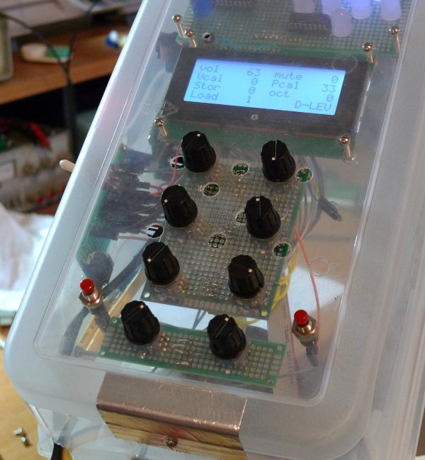

Today I added two new pushbuttons to the D-Lev prototype control panel:
They are the red things a the lower left and right.  These are old Radio Shack product, quite possibly the bounciest, dirtiest, on-impedance-all-over-the-place, most vile pushbuttons ever made by mankind, so they should be good for torture testing my software debounce algorithm.
So far I've got the one on the lower right working, it performs the auto-cal when pressed.  The physical positioning of this button is interesting because pressing it places the right hand in the pitch mid-field, so the "Pcal" encoder has to be adjusted somewhat to account for this.  But once it is adjusted and saved to slot 0 (which saves both the current voice and the system settings) then it doesn't need to be adjusted again.  I believe there is significant value in having the pitch hand positioned in a known, highly repeatable location like this while doing the auto-cal.
The one on the lower left will perform preset write.  The sharp observer will notice that the "Load" encoder has moved down one position on the LCD display, and the "C/wr" encoder has been replaced with a "Stor" encoder.  This is more or less how things used to be before I changed things to a single encoder load / store situation, which I found to be rather awkward and kinda dangerous if one is the least bit foggy when doing a preset write.  But this time I'm going to have Stor follow Load when Load is rotated (i.e. when a preset is loaded), and Load will follow Stor when a preset is saved.  This way the thing being edited will always be the thing just stored, rather than the thing just copied.
