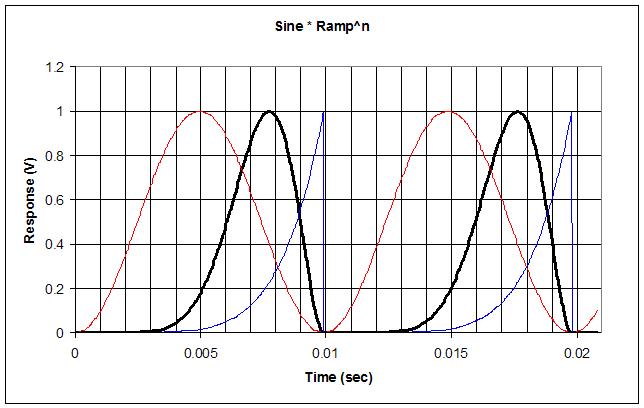

Sine * Ramp^n
A lot of glottal generators run a phase ramp (raised or unsigned sawtooth) through one or more non-linear functions.  I got the idea yesterday to take a standard NCO phase ramp, feed it to the SIN2 subroutine to generate a sinewave (as normal), but then take the phase ramp and square it several times, then multiply it with the raised and normalized sinewave.  More squaring of the ramp makes the result lean over more, makes the duty cycle narrower, and increases the speed of the falling edge:
The above is 3 squarings (8th power) in Excel.  The thin red trace is the sine wave, the thin blue trace is the multiply squared ramp, and the thick black trace is the result of multiplying them.  It sounds pretty good and doesn't alias much.  Harmonic amplitudes are nice and even with no dips.  I can hear what they mean by "openness" or a thinning of the bass and accentuation of the harmonics when the squaring is increased.  And I can also now hear the reason for independent control over the openness and harmonic content, as you might want more harmonics but not have this cut the bass content.  I've got it coded so that 0 squarings give a sinewave, and there is a small second order polynomial that normalizes the output amplitude based on the squarings.
It's running on the prototype, but there is an obvious DC balance issue; they were careful to remove this from a similar function in one of the papers I read.  The multiply squared ramp  should probably be more of an exponential to make the slope at the very end steeper, to give more harmonics with a wider pulse, and thus a better balance of bass and treble.  But honestly it's pretty good, stable, and simple to implement.  Just multiplying the unsquared ramp makes it jump from sine wave to vocal sounding, but the ramp squarings really make it shine.
[EDIT] Just stuck my old "poor man's" glottal generator back in and I actually like it better than the above.  It does super low "fry" type sounds infinitely better, so it covers a wider range without adjustment.  And there's no DC offset to worry about.  Lots of smart guys barking up that tree above though.  OK, lesson learned, now I really don't care if the wave looks anything like electroglottalography or inverse filtered human voice.

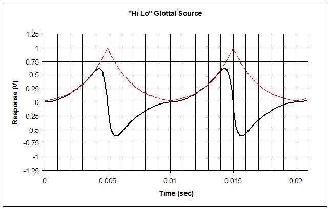

"Hi Lo" Glottal Source - Nailed!
Hoo boy, was thinking the "poor man's" glottal generator could use a scoop out to reduce the low frequency content, it hit me that I could take the NCO phase ramp, XOR it with its MSb to flip the upper half down, then flip the MSb to add 1/2.  This gives a triangle wave that goes from 1/2 to 1 to 1/2 to 1 to 1/2 over the full cycle.  Repeatedly multiplying this with itself gives a big-top tent-like double scoop, which I simply multiply the "poor man's" glottal result with to morph it even further:
Above is what it looks like in Excel with the "poor man's" multiplication count set to 3 and the new multiplication count set to 5. The thin red trace shows the new morphing function, and the thick black trace shows the result of multiplying it with the "poor man's" morph.  Note that the big-top function peaks where the "poor man's" edges are happening, so the upper harmonics aren't super-affected by the new parameter.  This is why I'm calling it "Hi Lo" because the "poor man's" parameter mainly sets the highs, and this new parameter mainly cuts the lows.
The controls can be set to give a pure sine wave, a rounded square wave, a rounded sawtooth, etc.  It would probably make a great generator for analog synth emulation with not too much aliasing spatter if not set too extreme.  If you can do floats then the two input parameters could be made more continuous, but discrete integer multiplications give you enough control if you aren't articulating things.
It sounds pretty amazing on the prototype!  It doesn't look all that "glottal" but who cares.  I believe the whole point in getting the harmonics of the generator right is to balance the vocal "fry" with the upper registers (why does no one discuss this basic point in the academic literature?).  My previous (today) sine * ramp^n didn't do that, but this one does, and with no DC offset problems.  With this I believe I've reached the end of my glottal generator endeavors for the time being and can move on to breath / vocal dynamics.  Will post a video or sound file of it in action soon.
