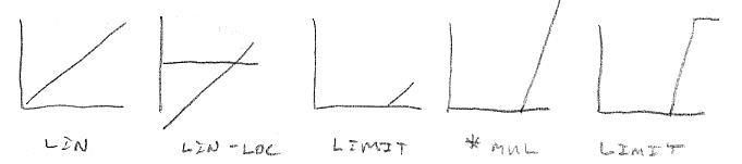

The linear axis number range is shown at left. From this we subtract the Vloc or Ploc knob value (the knob value is left shifted to make it full scale, then offset to cover the range [0.75:1), or 48dB in linear axis space). This is limited to lop off the negative values, then shifted right twice to divide by 4 (not shown, this gives mul more low end range), then multiplied up by Vmul or Pmul (the knob value is squared to extend the dynamic range), then limited again to lop off values too large to fit in the 32 bit integer register space as an unsigned value.
