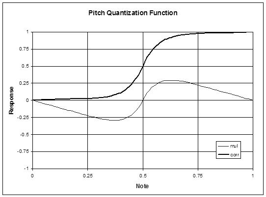

The above is an Excel plot of the correction function generated via various logical transformations and repeated squarings (here 3, or raised to the power 8) of the note ramp. The lighter trace is the correction function multiplied by 0.9, and the darker trace is this added to the pitch number to produce the corrected pitch number from note 0 to note 1. Note that there's a broad plateau at each note center, the correction isn't "perfect" due to the 0.9 multiplication, and the transition between notes is fairly steep but smooth.

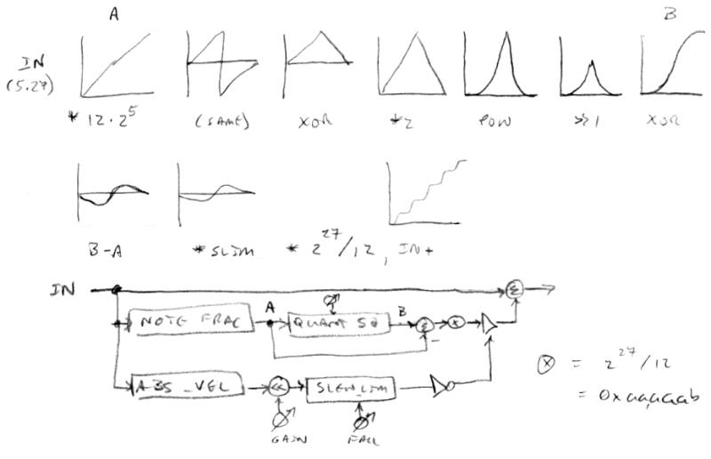

I got the above up and running on the D-Lev prototype the other night and have had a couple of opportunities to play around with it. The upper graphs show the transformations applied to the note ramp to get the correction function. Modulo multiplication to get the note fraction, XOR via full-width MSb to fold the upper half down, *2 to get full scale, repeated squaring, then backed out doing inverse functions, laid down on the x axis via subtraction of the note fraction ramp, followed by note scaling, amplitude modulation, and mixing with the pitch number.
At bottom is the signal flow with three paths. Top path is the mix, middle path generates the correction function, bottom path modulates the correction function. In the ABS_VEL block the absolute instantaneous velocity is found via subtraction of the previous pitch number sampled at 48kHz (differentiation), then 4th order low pass filtered at 15Hz to reduce noise. Bulk gain is applied via left shift. The result is slew limited in the fall direction only, giving a leaky peak hold. Finally a negation of all bits reverses the direction.
